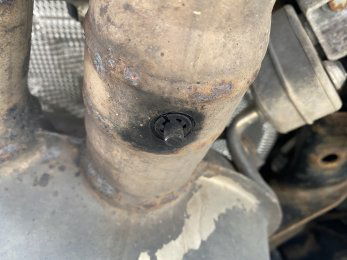

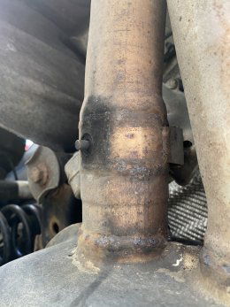

No that didn’t work but I think I’ve found the cause of the rattle. On the left side it looks as though a washer of some sort has broken off? When I push the cylinder shape coming out from the bottom during a cold start up the rattle stops. Hopefully the pictures explain what I mean better.
Going to take to Audi and see if they agree with me. I’m assuming it’s a case of just putting new washers on both then? (As the right side one is cracked).
Audi will just want to sell you a new exhaust rear section.
If it’s not under warranty, I’d source some of those lock washers and put them on yourself.
Save the stress of dealing with Audi.

Like clockwork you called it. Audi Tech said they have to replace the whole rear exhaust system...
Any chance you know of where I can get hold of those washers? I’ve looked online and can’t find a part number or anything.

Measure the shaft dia and order the washers that are suitable.
They don’t seem expensive in the link.
That’s what I would do.

Looks like I need a 7mm washer so I’ve ordered two off Amazon and will see if they fit right and if it stops the noise.

Sorry to hijack the thread, but is there a fix for the issue in the second post? I have this exact issue and stops if I apply pressure. I do have extended warranty. Would this be covered?

I’ve had no luck in finding a washer that will fit. They don’t seem to make them anywhere. Not sure if it will fix the issue either as it looks and sounds like it might be a bigger issue.
