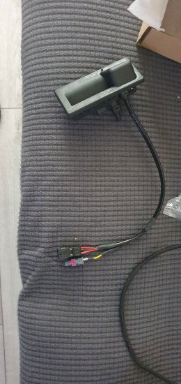

Hi All,
I'm looking for a little guidance on finisshing off my reverse camera retrofit. I bought a genuine audi camera kit and fitted it as per the instructions. I've now come to code it in and I'm having issues. I've found lots on forums but nothing specific to the A4 B9 and other cars all seem to have slight differences. The kit came with an activiation pack which has a code, an activation numvber and a PIN. I called Audi and they say I need to to take it to them to get it working using the activiation pack and I won't be able to do it through VCDS. Is this correct or can I do it? I have VCDS and have already attempted with no luck. Any help is massively appreciated. Here's a scan:

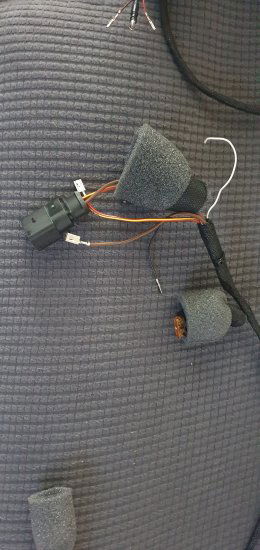

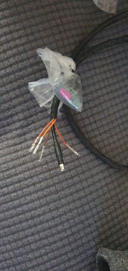

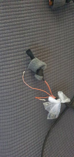

Was your loom anything like this ?
Steve.
