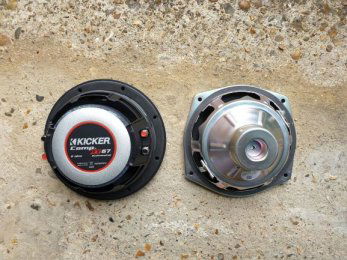

I purchased the B&O sub spare wheel mounted sub from EBay for less than £100. It comes with a 100w dual voice coil driver. However, once I pulled this driver out it was very apparent that it wasn’t up to much. So I set about finding a replacement driver. See pictures of the magnet assembly of the B&O driver (right speaker in photo) compared with the replacement unit I used:
Kicker  B0
I went for a Kicker Competition 6.75” driver, dual voice coil, this is it: Kicker Comp RT672. There are very few that are this size and I also needed a narrow mounting depth to fit into the B&O enclosure. I should say at this point that if you are going to go down this route and not using the B&O driver then you can save yourself some money by buying the A** sub as you only need the enclosure. However even with this Kicker driver the sub enclosure needs modifying for the driver to fit properly, as follows:
  • An 8mm 165mm MDF speaker mounting spacer is required. I got a pair from Amazon for £6.89 see here: speaker spacer. Sprayed matt black for visual continuity.
  • The Kicker driver requires the plastic trim to be cut away as per the photo above: It can’t be removed entirely (I spoke to Kicker customer support on this) as the plastic moulding supports the speaker connections.
  • As the enclosure is a plastic moulding with some resonance, it ideally needs filling with speaker dampening material – here is what I used: speaker wadding
  • The knurled nut that holds the sub in place needs trimming as per photo below:
    Knurled nut
    this is so that it can be turned with the bigger drive unit in place.
  • I also modified the cable routing so that it has a cable clip so that the connections to the sub are not under strain.
  • You’ll need a substantial quick release connector for the sub wiring, and I used this: amp quick release connector purchased from eBay.
  • You’ll need the longer bolt to hold the sub into the spare wheel well, see parts list attached for details.

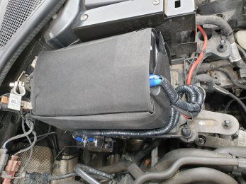

Big thanks to Phil at Road Radio (Redhill) for his patience and work on this. We used 2x Stinger amp wiring kits, and Audison Line output connector and Audison interconnects – these are very high quality and shielded which is important. I’m not going to go into huge detail here as I assume you either know what you’re doing or will get a professional to do this. Suffice to say what needs to happen roughly is:
  • Engine bay – battery removed and power cables run off +ve terminal off battery and run through the bulkhead (there are holes for this). The kits I used were 4AWG gauge wire and with 2x40amp fuses (!!)
  • Line out convertor fitted – this sits inside the dash and you need to remove the glovebox and MiB unit to fit, there are other guides on here on how to remove glove box so I won’t repeat that here. Make sure you use a high quality shielded one. I used this: Audison Connection SLI4 line output convertor
  • Wiring run from LoC to amp along the transmission tunnel (under carpet)
  • Earth cable run from amp to main vehicle earth
  • Output from main amp to sub amp via RCA cables. You’ll need 5 metre ones.
  • Make sure all cables are secure and properly wrapped with loom tape to avoid rattles
Pictures of this part of the install are below:
Fuse holder and power in engine bay
Fuse install detail
As I mentioned before - you need to remove the passenger seat to do this easily. Be careful re airbag, make sure ignition off and key out before undoing any of the connectors, and ideally undo main battery.
