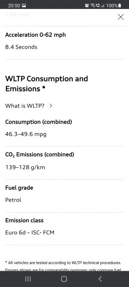

Audi's own figures below for the 1.5tfsi
Manual
Screenshot 20210524 204933 Chrome
Auto
Screenshot 20210524 205026 Chrome
