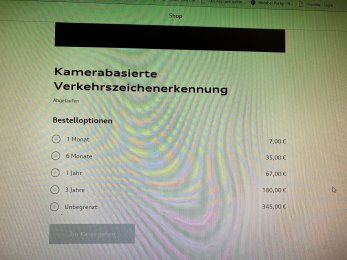

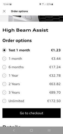

Could someone advise what the lifetime costs are for each option please ?
High beam assist and Camera Based Traffic sign recognition costs attached.

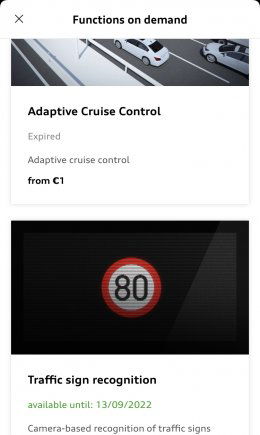

Think I’ve found a hack in the purchasing,
So did the usual to change the country on the my Audi app…. Logged out of the app and on login changed the country by the drop down menu on the little globe on top left had side of the log in page.
I purchased the traffic sign and adaptive cruise for the trial period of a month for 1 euro, this was done on the Ireland settings.
When the free trial was up I logged out and logged back into the German site by using the globe drop down to change country, purchased the traffic sign for a month as the German site is the cheapest country……. Logged back out, changed back to Ireland site and I could purchase another months trial of adaptive cruise for a month trial for a euro.
So instead of paying for 1 month to a lifetime at a huge markup just purchase what you want on the Ireland site for a month trial 1 euro, then when it expires switch to the German site and do the same, then just keep alternating between the sites……. Just remember to do it once the trial has expires as whichever country your logged in at it shows your purchase till it expires
