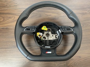

Picture 1 - s3 flat bottom dsg

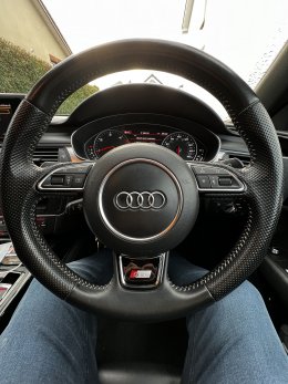

Picture 2 - A7 circular wheel
Now I will try this way - dual stage bad from A5/A4 to match flat bottom wheel , then I will swap the cables from my A7 airbag to the new one so my steering buttons will keep working. As well as I will swap the S3 wheel buttons with my A7 so they can match ..

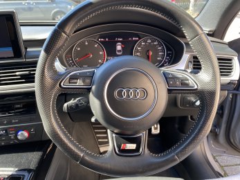

Have the same wheel as pic 4 because of the flappy paddles - live them !

In the process of doing the things :) the buttons were swapped from the S3 wheel so now everything work as it should
The bag must be correct one not only any dual stage
Reactions: audiA7kidd
Was a pain to find the right airbag but here is the result. S3 wheel with the new type flappy paddles and airbag for A7 flat bottom.
Buttons from my old wheel were swapped as the S3 wheel buttons look same but they are different can't be more happy

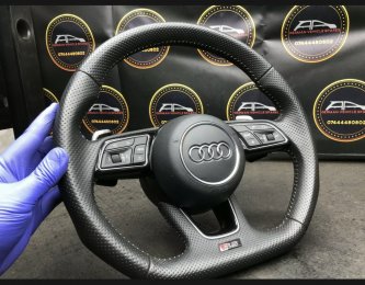

hello, did you get the new steering wheel complete with the airbag or you purchased seperately? asking if a A4 A5 B8.5 Airbag will fit correctly on the RS steering wheel.the mounting looks the same, but maybe it could be different at the airbag connectors. Thanks!
Well if your talking about the airbags shown in the picture, only the top one will fit a flat bottom wheel - the physical mounting fittings are different.
Regarding the actual airbag connectors, they are keyed differently, depending on the model.
