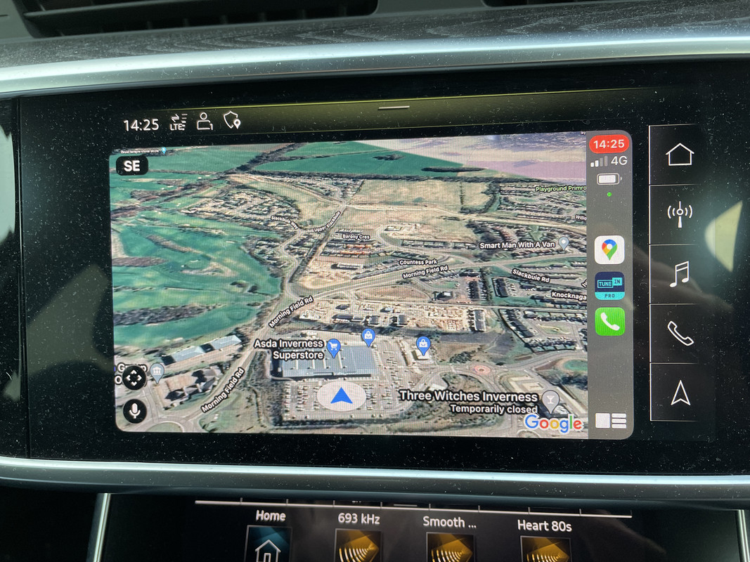

One small issue: I mainly plan on using Google Maps in Car Play ideally with Google imagery in the back ground. I had it working initially but its gone back to standard google maps without any imagery, any idea on how i can get the imagery back in the MMI? I can switch on the imagery on the iphone but its not replicated in the MMI. This is what I want to see:
Many thanks again OP! :)
Ok managed to get satellite imagery again in Google Maps on MMI screen. After selecting satellite imagery on iphone, had to close Google Maps on MMI, and then after re-opening, imagery appeared again.

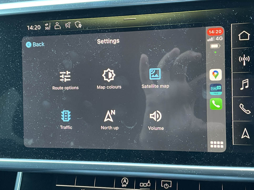

How would I do this? I can't see any setting within CarPlay Google Maps which allows switching between standard and satellite maps.

While in CarPlay Google Maps tap on the screen. You should see settings icon.
Once you in you should see something like the screen below.

Thanks, do see the 'satellite map' option under settings so all good on that front. However in your screenshot there's a 'speed limit' option yet i don't see this? Also how do I add/remove apps on the right side, which I presume are short cuts or frequently used apps? Many thanks!

Please ignore my photo as o just grabbed it from the web to show how to switch between Google maps satellite and standard view.
