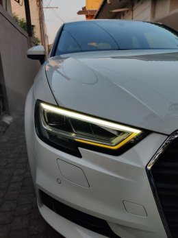

Thank you it was very helpful... I have the lower portion of my light which is yellow. but im assuming if that is separate from the top of the DRL that too should also have a light source right? Has anyone managed to resolve the bottom part of the DRL by switching out the module?

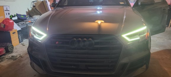

My 17 S3 just did this in the past week? Did you end up fixing it? The bottom part of mine also died. I'm not sure if there is a second source of light for the bottom.
