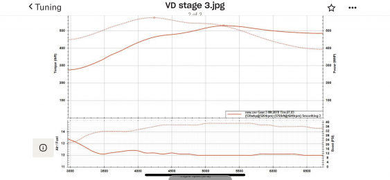

Upgraded to the latest oil screen revision. Flashed stage 3 straight away. Virtual dyno puts me around 530 bhp at the wheels so somewhere around 650bhp

Cooling is recommended but not essentially. It’s running great with no KR but I’ll probably run wmi at some point and turn it up another notch
