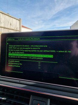

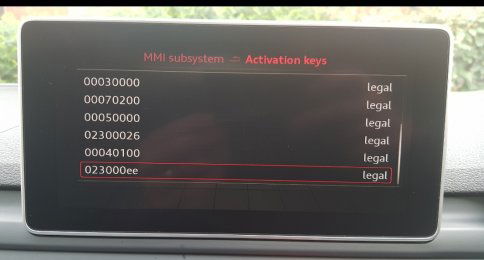

How did you do the patch? I've got the green screen, installed the AIO patch but it hasn't updated the fec code to 0230002ee. It's still just showing 02300020.
My 2022/23 maps work when I start the car for a few mins and then goes off and just displays I don't have the correct data or something similar.
Have you selected to add the fec via the green menu? Just patching doesn't add the fec 23000ee.
You old fec will still show 23000ee needs to show as valid
I think I have? In the picture where is says "add_feccontainer.fec" .
I've just looked in that folder at it doesn't have 0230002ee in there, it only has 02300020 so that's why It's not adding it I guess... how do I add the 0230002ee fec?
I was being thick, for some reason I thought the correct patch was pre loaded in the M.I.B download and I didn't realise you had to download the patch separate... I dropped the correct patch in the folder and applied it. All working now :grinning:

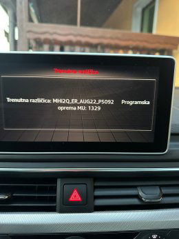

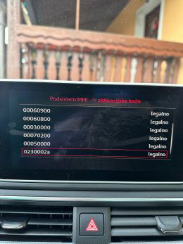

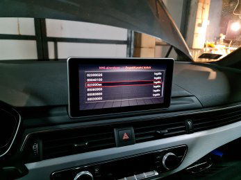

Hello i want to update maps, can somebody please help me?
