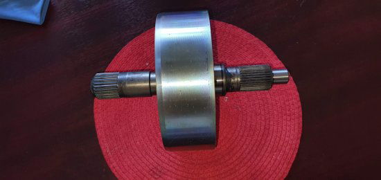

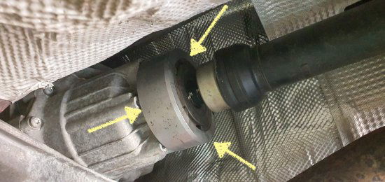

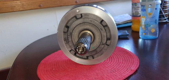

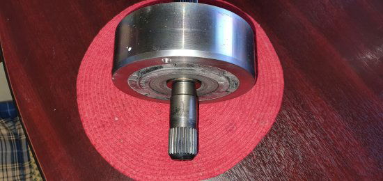

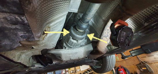

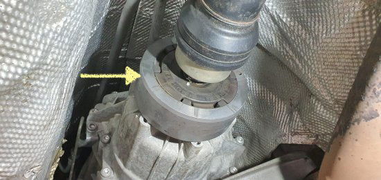

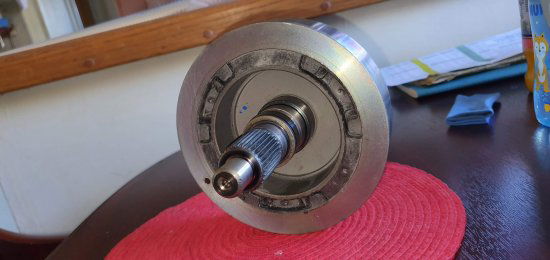

After getting the car back up on the ramp, I've been able to confirm part 8 is the part with the issue. The central rubber is coming away from the aluminium housing.
My next issue is understanding how to remove the existing part from the gearbox and prop shaft [images below] and then fitting the replacement. The new part is splined at both ends and doesn't have anywhere obvious that might utilise bolts to affix it.
Do you know or have any insight as to how i might be able to remove and replace this dampener?

Existing part in situ
20210413 091307
20210413 091131
20210413 091127
New part
20210422 08100020210422 08100620210422 08103520210422 08104220210422 081055
Looks like it is retained by a circlip in the back of the centre differential housing.
https://audi.7zap.com/en/rdw/audi+a4+avant/a4/2013-736/4/409-409080/
You have to remove the rear part of the gearbox which is the centre differential housing.
very helpful - thanks. Potentially a gearbox specialist job, if my mechs are not able to remove the housing
On the exploed diagram, part 4 is a protective ring and parts 12, 13 are securing ring. I wonder if one of those are the circlip that you refer to?

The image came from one of those Elsa Win but it's the same process document as you have linked too. The rear case of the gearbox that houses the centre diff needs to be removed . That is after you have removed the exhaust , propshaft and a few other bits to get access to the end of the gearbox.
Parts chap from Audi Hitchin was helpful. I'd ordered the balancer from him a few days earlier and called back to enquire if any other parts would be required. He's identified the circlip from the gearbox side and a 'one time use' jubilee clip on the propshaft. I hope that these are the only additional parts I need for the job.
I managed to find those PDFs using the code on the gearbox houseing image you posted, so v pleased with that.
