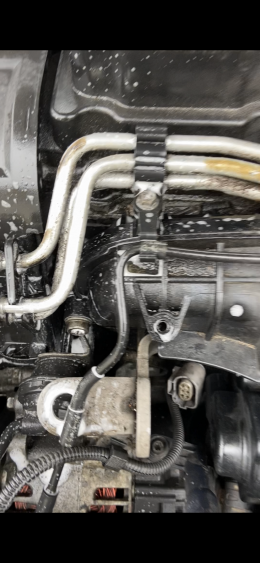

Hi all,
Just got the car back from the garage after trying to diagnose dpf problems. Nothing came up on diagnostics.
He's spotted a build up of carbon on the left side of the engine (see attached photo) and says I need a new intake manifold as it's leaking. Cost of part from Audi is £600+. He suggested finding one on ebay and they can fit it.
After some searches I can see there is plastic and aluminium versions and some have switched from plastic to alu.
Firstly, do I have the plastic or alu version? May seem a silly question as obviously looks plastic but just want to check.
Secondly, how easy is it to remove and is there any instructions? I'll take it off to have a closer look if not too difficult

Make sure you plug the swirl flap actuator’s vacuum line when you change to the BKD alloy intake

you can remove the vacuum hose going to the intake manifold actuator and shove a screw into it to disable it.

If the vacuum actuator is leaking all the engine vacuum (non-referring to a manifold air leak), then you will remove the vacuum leak from the system.
therefore the turbo can then use the vacuum to activate. With a vacuum leak the turbo cannot move = zero boost
(Providing it is the actuator on the manifold which is leaking Vacuum since you mentioned you hear the noise at this exact area , which by the way is an extremely common issue)

Correct
