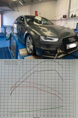

Eventually got round to it and got a custom ecu stage 1 remap put on the car with some dyno time.
Remap been on for a good few months now, since May. After selling the tuning box and putting that towards the remap it only cost me £204.
Remap
Overall very pleased with the results and got some good gains.
My car had a older version ecu in. Should have been the newer version for its year, so was a little more limited in pushing it for a few more extra bhp. Not that you would have noticed the difference.
Only regret is, in hindsight, l should have done this earlier before even buying a tuning box, wish I did it years ago.
