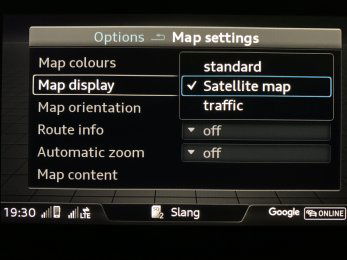

Hi
yes it still says Google in the right.
two ways to check
(I). Look at the top of the screen and it now says Inagery (c) getmapping plc
(II) in map setting the map display option now is “satellite map”’rather than Google maps
Screen grabs below
62F5FB5B A34A 470D A515 85DAE8B0F5C2
Hi
two ways to check
IIRC while it still says 'google' on the bottom right of the screen but the associated progress bar disappeared after the update.
I think they are and I don't know why it would 'take time to work' - it certainly did not in my experience
What is your software version as that should definitely answer the question
