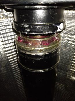

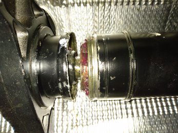

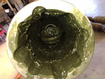

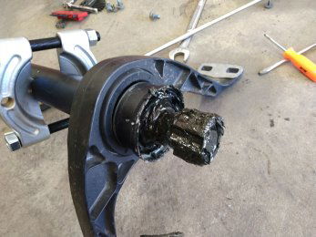

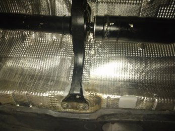

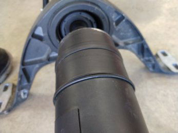

1: remove drive shaft get two flat head scre drivers gradually pry the rolled lip up off the dust cover.
2: Pull the rear drive shaft out inspect your components, make sure the cog gear is seated right, it should be flush with the race.
3: clean up all the grease with rags and parts cleaner get a thin rod at hardware store, through the back of the shaft gently tap the cap back into place, apply some jb weld around it to lock it in place and prevent this stupid @ss design.
4: with two people install the front shaft on the vehicle put two bolts to hold the carrier bearing.
5: with the cage greased install the balls in place put a peice of cardboard in front of it to prevent the bearing from sliding out, Hold the cardboard! Have a friend install the rear half of the shaft, then slide the dust guard over it gently tap the recess grove or apply a little jb weld.
Make sure the rubber boot is concaved inwards you should be able to run your finger and feel smooth recess.
When you lower the car and add load that last few mm should close up.
I hope this helps people! If you have any questions feel free to reach out, I see Alpha motor sports is making a drive shaft for this, if they don't I will. If you are running upgraded power I would highly suggest a custom 1 peice shaft, and screw this cv design.
