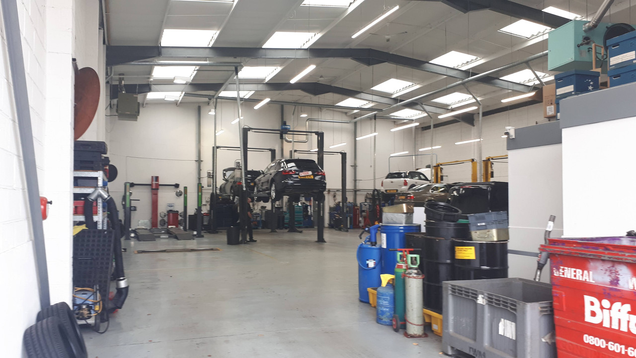

1. I was less than 5 mins away from my preferred Vw/Audi indi that I’ve used for ten years plus, so the first thing I did was rock up and ask them if they could do a quick inspection. Luckily they fitted me in straight away ( being a loyal customer helped, their getting a crate of beers this weekend ) and apart from the usual wear and tear, couldn’t find anything of concern.

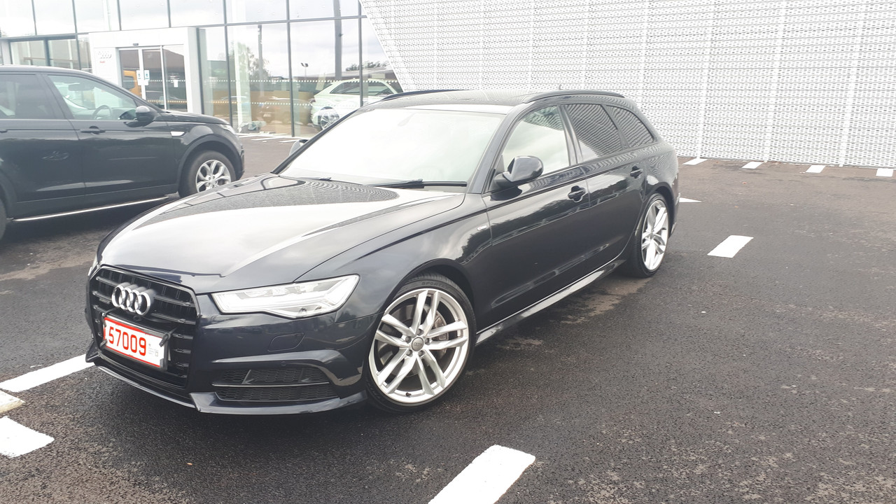

So what did I get? The details are:
Audi A6 Avant Black Edition 3.0 TDI quattro 320 PS, with the following:
• Midnight blue
• Flat-bottomed steering wheel with gear-shift paddles
• All-LED headlights including high-beam assist
• Black Edition
• Electrically adjustable front seats with memory function for driver’s side
• Heated, electrically adjustable, electrically folding and auto-dimming, with automatic kerb-view
• Panoramic glass sunroof
• Technology package

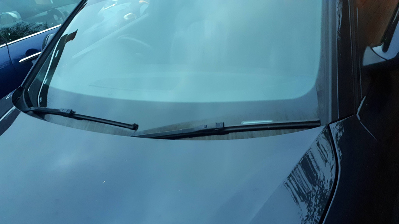

My passenger wiper arm is doing my head in, I'm thinking it's too far up? I can see it from the driver's seat. What's it like for anyone else?
It should be covering the VIN number, that is a good couple of inch too high.
Reactions: rjwojcik
Yeah that’s too high when comparing to mine. Has the windscreen been replaced? They may have had the wipers off just a thought
Reactions: rjwojcik
God knows, but thanks. From what I've read, you can unbolt the arm and adjust it. Small job for the weekend.

Remember Park ur Wipers 1st on ur MMI Screen, And close the bonnet before Starting the Car.. They Park Automatically if you start the car with the bonnet up.

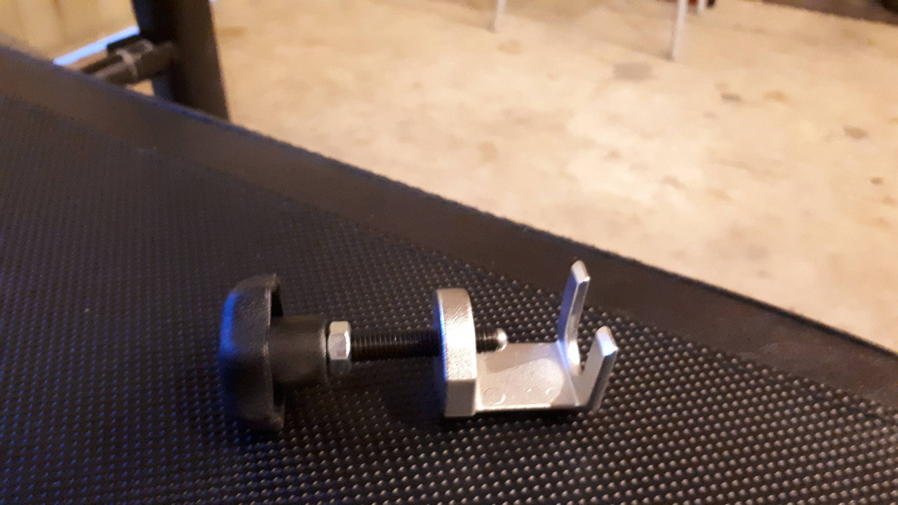

All sorted...
A bit of a PITA removing the arm, tried WD-40 but had to invest in a Wiper Arm Removal Tool in the end.
