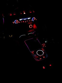

Finally had my MIB2 installed on my PFL with my upgraded RED LED FL MMI controller, so the whole thing looks exactly factory, none of that White LED panel with Red LED dash half baked stuff.

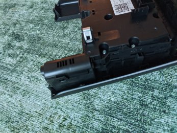

Also just wondering (if you can recall) about getting access to the board/LEDs, is it only screws holding together the MMI panel or are there any clips? Don’t want to break anything while trying to pull it apart lol.

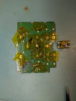

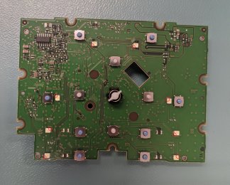

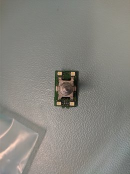

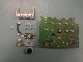

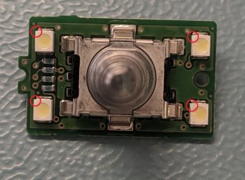

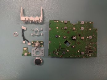

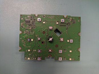

These are all the pictures I made. Most important thing to keep in mind is the rotation of the LED (anode/cathode side). With a multimeter in diode mode you can test the originals, the Würth ones you can check from the datasheet (or also test)
Thanks for the photos and yes I can see how you have circled the LEDs to indicate the correct orientation - really helpful to use as a reference.
Will give it a go at some point soon and post results if possible. Appreciate the advice mate!
Yes, for me it was easier to remove all leds first and then put on the new ones, hence the picture and circling the marker side.

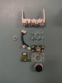

Hey @FPSUsername - I managed to get the LEDs you suggested to order so will attempt the installation soon. Thanks again for the link.

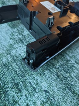

A quick question I have that I was hoping you could answer is regarding the disassembly process for the MMI panel. Am I correct in saying the volume knob first needs removed (by pulling it firmly upwards) and then it’s simply a case of removing the screws at the bottom of the MMI panel to get access to the boards / LEDs?
Just wondering are there clips to worry about anywhere as well basically. Cheers

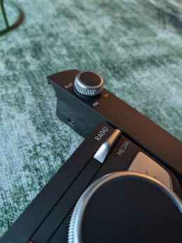

Hey @FPSUsername - just a quick update to say I’ve successfully done the conversion, the new LEDs look perfect so thank you for the link to them and all your advice!

Did the cupholder LED retrofit while I was at it. The finished results:

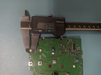

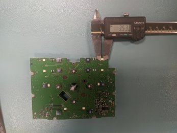

Thanks a lot for getting back to me, since I already have a custom flat-bottom facelift heated steering wheel, I won’t be able to go the TT wheel route.

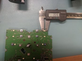

I’m considering purchasing 12-14 of these LEDs for the steering wheel buttons and the paddles. Before I do, I just want to be 100% sure the ones you recommended would fit?
Disassemble the buttons and look at the pcbs. I don't have pictures of them but I did once see them and from my memory, they're use the same LEDs. Maybe you can find pictures on drive2.
Have you ever disassembled the buttons before? They seem to be sealed units and I’m unsure how to disassemble them - if you have any instructions or tips I’d really appreciate it. Thanks
IMG 0629
IMG 0630
My friend, I purchased the würth ones already, but I think these original factory LED dimensions are different from your photos - any advice on what these would be? I assume the same brand (würth) and colour can be the same but since I have no experience with LEDs, which ones would fit? Thank you.
The Würth 150224RS73100A (Red) would fit those, package type 2214, 2mm long, 1.4mm wide.
