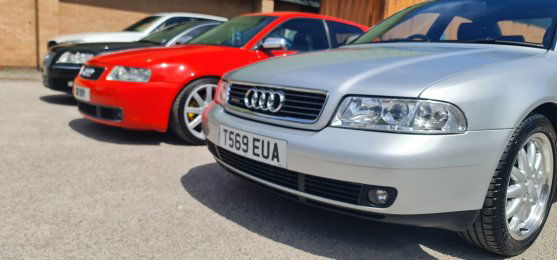

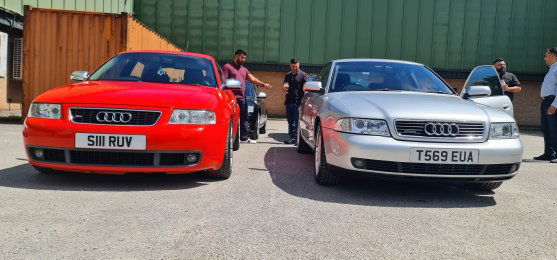

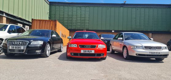

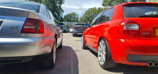

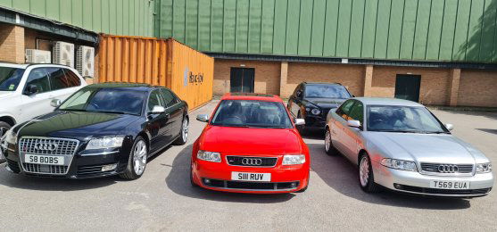

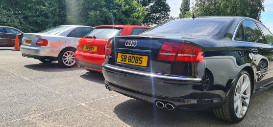

Car looks awesome, if anything better in real life gops!
Nice mini meet we had the other day! Hope you don't mind me posting the pic.

These look awesome! Was good to see you, car looked gorgeous!!
