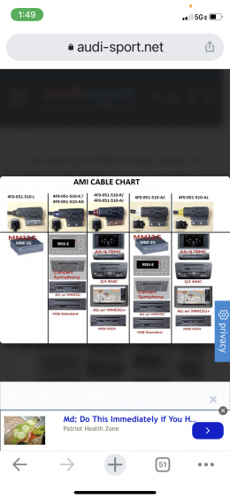

Hi, I was reading your thread on carplay. I bought the same unit. However, I have tried 3 different AMI cables and I get the same result with each one:
AMI not connected. I have tried AMI to AUX and AMI to lightning. Nothing. Phone doesn't charge either. Does this need a special kind of AMI? I have a 2015 Audi A3, same controls as yours, AMI in center armrest. I don't know what else to do.
Reactions: Deezer-D
You need this one, none of the other AMI cables work.
You just plug it into the AMI port, no need to connect anything to it. If you want to charge your phone via the CarPlay kit, connect it to the USB lead provided.
I’ll take a pic of mine later

I tried two different cables like the one in you picture. I have not tried that brand. The MMI system just does not recognize anything connected. I am thinking there may be something more to my problem. Is this the brand I should try?
I have only tried this one and it works no problem. Have you tried resetting the CarPlay unit? No need to plug anything into it.

I’ve tried everything. I think it has to be the cable.

Can you do me a favor and tell me which software is on your MMI? Mine is MIB standard. From what I’m learning, there are different cables for different software versions. I think you may have a different software version than me.
This what you need?
Sent from my iPhone using Tapatalk Pro
Yes, thank you! You have a different software version than mine that’s why the cable with the yellow collar works for you. I don’t think the yellow one would work for me. I found this chart on eBay. I’m going to give it a try and get the one with the white or blue collar since I have MIB standard software and I think yours is MIB 1. I don’t know why Audi has to make this so complicated.
The cable I have doesn’t have a coloured collar on it though. It’s just the one I screenshot from Amazon. It has to be the AMI to 3.5mm female cable for it to work. It tricks the MMI into thinking the CarPlay unit is connected via Aux. You should get a notification at the top of you instrument cluster saying External Media Source Aux or something similar - will take a pic in the morning
I just bought one off of eBay that has a blue collar but it is an AMI to 30 pin for the old iPhones and ipods. But it’s a OEM part from Audi and it says it’s compatible with my MMI unit. For $10 I’ll give it a try.
It won’t work. Neither will a lightning one or a male 3.5mm Aux. The only cable that will work is the AMI to female 3.5mm. The end of the AMI cable must look like this to work (pic sent to me by seller of CarPlay unit)
Well I can’t find the right cable if it has to be a female 3.5. At this point I don’t care about the CarPlay. I just want my auxiliary connected on my screen to light up. This cable I bought off of eBay should do that. My MMI Unit is different than yours. The one the seller supplied with CarPlay doesn’t work for me and it looks just like the One on your picture..

I did not even install the CarPlay yet. Before I go to that I want to make sure the aux lights up on my screen. Right now it says not connected with any cable. Yours displayed aux connected before you even got your CarPlay.
You might need to enable Aux on the MMI?

No, that’s not on my model. It has to be the cable I believe. I am going with the oem version for my MMI. I don’t know what else it can be.
Hopefully it works. Sorry, I’m all out of ideas. Good luck and keep us posted
