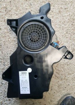

    This is the Blaupunkt subwoofer, this sub has a build-in AMP. The Bose soundsystem has a seperate AMP.

Place the subwoofer in the desired place. The SUB is hold by three bolts. The cut should be perfect for the subwoofer to fit in.
The cables that you run from the HU to the SUB need to go into the blue SUB connector. The pinout for this connector is shown in the table under the pictures.

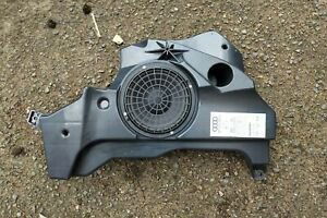

@LibnikxD actually woofers are not same, for 3 door there is extra hole, so better find for your car
Reactions: henkkeumus
You sure? I thought I got my woofer from a scrap 3 door and put it in the 5 door trunk behind the left trunkcover.
absolutely, woofer in center is for 5 door
