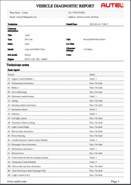

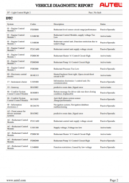

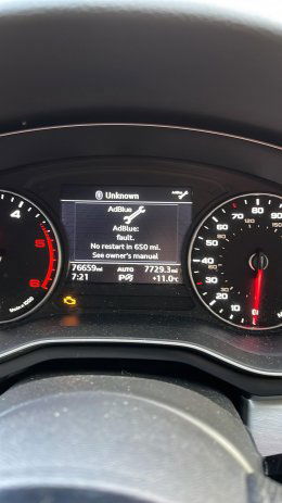

Hello,
I have an Audi A4 B9 2.0TDI seams that my AdBlue system start to fail on me to, I have engine light on and from time to time start appear "AdBlue Fault. No restart in 650 mile" this error in dashboard appear only when i drive, after the car is stop and start again the error is not there anymore, but engine light is still there.
So today i was on my local garage for a check and they check the AdBlue Injector on engine bay and clean all the electric jack's from the AdBlue tank (under the car), they test the pump and sometimes is working and sometimes is not and the cable that is going from tank to injector to engine and look like adblue arrive there.
The conclusion was that they will try to check what is the problem actually and from where this problem start in first place because for them was very strange that the pump work and cables the same but on tester they have error codes, and they don't want to put to change something till they don't know for sure what is the real problem.
I leave attach for you guys maybe you someone has any clue.

Various combinations of warning lights, no restart in 650 miles, AdBlu spanner, EML warning, sometimes all three, other times two or sometimes just one. AdBlu tank and J880 sensor replaced under extended warranty with just the £250 excess to pay. The warranty payments have earned their keep today.
