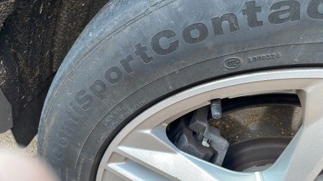

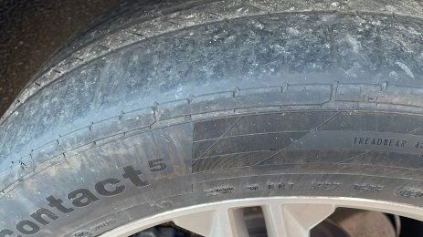

Hi Ibought a Dec 2021 Q5 19000 miles, My Garage manager astute Grandson and myself both didn’t notice the excessive tyre ware on the near side rear tyre, I phoned Audi Belfast to make an appointment and the first appointment available is 21st Dec 23 because of re calls, I said what if I get 3 points and was then offered a emergency appointment if I left my car with them for up to 5 Days and you must bring someone to take you home as they no longer run you to a bus station, I’m getting fitting 2 Audi continental tyres and getting a 4 wheel alinement in a Tyre Outlet, on sat 11 nov 23, Has anyone else received the same service and most importantly Can anyone inform me if Audi replaced the defective fault Tyres for free, Have recalls ruined the one time great Audi Service
