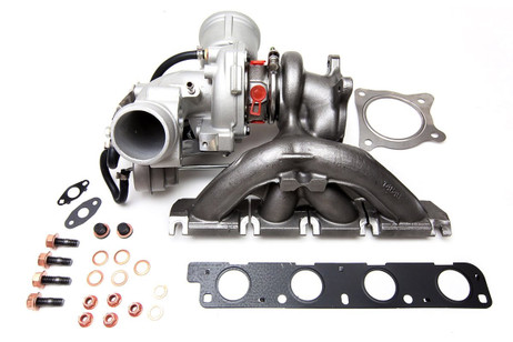

Saw this website today with a kit that on the surface seems like a good compromise, an upgrade over the 270 ish but not bonkers too much at 330 ish, that's s4 territory without the weight and v8 running cost.
Seems to be priced in line with most kits on the market offering similar spec and performance increases.
Any thoughts chaps.

Looks like a good option for some S4 power bud. 330bhp and what kind of torque?
With that kind of power would you stick with the standard 50/50 T2 torsen diff? I’d love to upgrade to a T3 with the 60/40 split RWD balance. Would improve the driving dynamics no end.
Do it.
Turbozentrum use a full size Ko4-0064 frame so it should flow a little bit better and be less stressed than the other hybrids on the market.
Any thoughts chaps.
I've narrowed down after a good amount of research to go with this kit , but add in other mods not included with the kit , plus a decent custom remap should get me to around a safe 400 bhp.
looks like the wallet is going to get a bit of extra use again.
