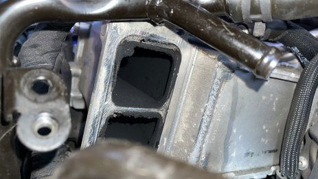

So I’ve finally taken the plunge and ripped into this. My charge cooler matrix is completely blocked with soot about 5mm thick along with the rest of the air path from the low pressure EGR. The EGRs are meant to be mapped closed, it looks like the high pressure hasn’t opened for sometime. Aiming to get the low pressure out tonight for a look and remove and clean the charge cooler.
I need to figure a way to blank the low pressure EGR outlet hose, might jam something in it that can’t make its way to the turbo.

So I gave up trying to get to the LP EGR, I’m hoping that the EGR cooler is sufficiently blocked that it won’t block the charge cooler back up so quickly.
Following cleaning the charge cooler it was still belching black smoke in boost but the power was restored. The following day it was like a new car, normal power and delivery, no smoke at all and better MPG. I’ll be interested to see how long it lasts but if it’s more than a year I can handle ripping it all apart again for another clean.
