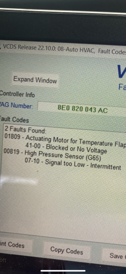

Hi guys I have a similar problem. I haven’t tried anything at all yet but I did get a fault code on VCDS of the ‘High pressure sensor’ . Ignore the top fault, that’s been sorted. But my car temp doesn’t go above 60-70 and I have exactly the same car. 04 plate 1.9 tdi 130 avant AVF.
