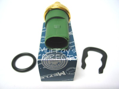

Is CTS Coolant Temperature Sensor, the green 4pin thing at back of engine?
Where did you purchase your thermostat and sensor from?. Audi quoted me. £42 for a sensor !.

The temperature sensor is a common fault among the VAG group of cats this age that could be why it’s not getting up to temperature on the dash.

At first I bought a Meyle CTS from a local motor factor but they don't contain a new Onion ring and clip , Murray's Direct , do .

CTS is ok if it tally's with VCDS.
