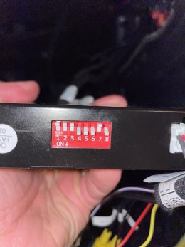

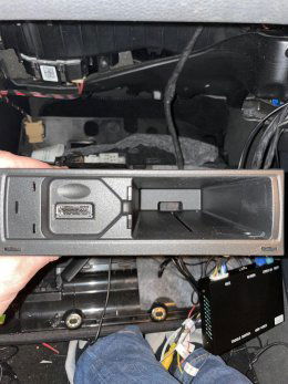

Fitted my 3rd one of these today to the wife’s car and I cannot get sound out of it! Have put them in mine and a mates car perfect but not the wife’s - worst persons to not work in!!! ‍♂️
everything is in right, car play fires up, can dictate to google maps etc, songs are playing but no sound at all. Go back to the radio and it’s fine?? I can’t help think it’s something to do with the MMI port the glove box? Would it be looking for that instead of through my phone?
Have tried all sorts of combinations with the toggle switches but just can’t get it to work. Any suggestions please?
pics of toggle switches and MMI in the glove box if it helps…
