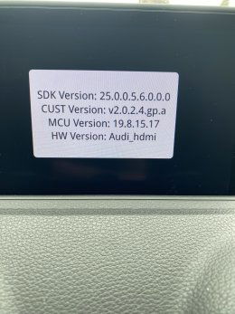

I have a carplay unit from Aliexpress as well, but the seller is not responding to any question.
I would like to update my carplay unit.
Does anyone have a link for the newest firmware for my unit?
Hope someone could help!
I seem to recall this was achieved through FW. Probably best for you to contact where you got yours from and request the latest FW for it.
Paul
