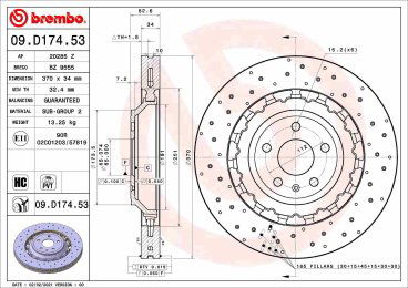

If anyone is wondering whether SALOON/SEDAN front brake discs are interchangeable with SPORTBACK/HATCHBACK ones - THEY ARE NOT.
They are all the same, except that the height of the former is ~53 mm, while the height of the latter is ~60 mm.
Or if I can rephrase the above using OE part numbers:
- 8V0615301R (FL SALOON/SEDAN) height is ~53 mm Link to external site
- 8V0615301S (FL SPORTBACK/HATCHBACK) height is ~60 mm Link to external site
I am attaching visuals as well (courtesy of BREMBO).
