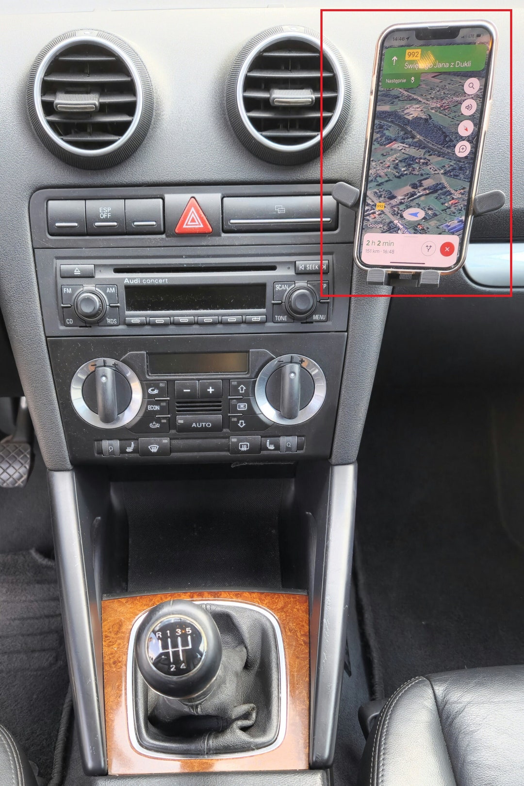

Hi,
You can mount there this phone holder:
1692718932904
