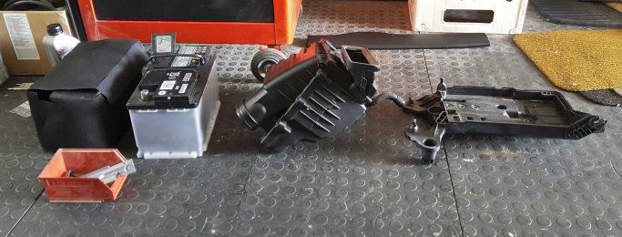

My Dad’s 2011 Meriva B 1.4 Turbo required it’s annual service so it was brought to VAGhall Towers for a fettle by yours truly.
It got a scan using my Delphi kit and only had one code stored which I had seen earlier in the Summer. It relates to the rear high level centre brake light and can occur when there are low voltage issues as the CAN bus shuts items down to save power. I replaced the original vehicle battery last month but never cleared the codes, my bad.
With my Dad not using the car much of late I thought it best I gave the new battery a top up with my trusty Accumate Pro and soon all was healthy.
Next up was the air filter change including cleaning out any debris from the air box which was pretty clean inside.
I then ran the car up to temp and changed the oil and oil filter. The oil has only covered 1,750 miles for the year but still very dark so no matter what the mileage it’s always worth swapping it out for fresh in my humble opinion.
When serviced it had covered 38,565 miles in ten years so I popped a spark plug out of no.1 to check the condition and obtain the part number as they have never been changed. Looking good with no issues to date but I’ll be changing them at the next service for extra piece of mind. Super Posh OEM plugs are NKG Iridium ;)
I always opt for active carbon pollen filters as they offer more filtering abilities and also help cut harmful polluting fumes outside the vehicle, they cost a few pennies more but worth it. Stock pollen filters are pure while but the active carbon look grey like this brand new replacement.
My final serving task was to wrestle with the dash as you have to strip half the car to replace the pollen filter. I can see why most people don’t bother but it’s not too bad having done it a couple of times on this car. Gently pull and if that doesn't work think happy thoughts and try again.

I’m pleased to say you can get to the DSG filter & swap it without the need to remove the battery, airbox or intake pipework. I must have baby sized medium hands as I didn’t at all struggle. New filter vs oil & in it goes. Spec states a torque of 50Nm for the filter but it’s plastic so I did the same as the engine oil filter at 25Nm as it undid with ease.
I knew I had photos somewhere, this is what I had to remove when I changed my DSG filter + oil last year.
DSG removed items sUnder tray clean s
