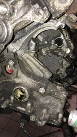

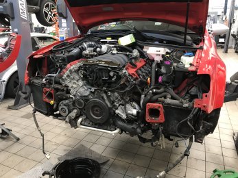

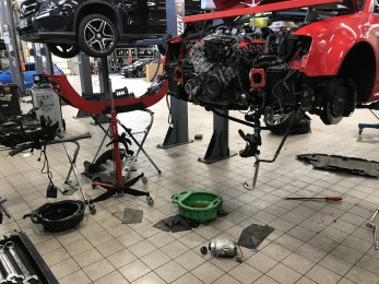

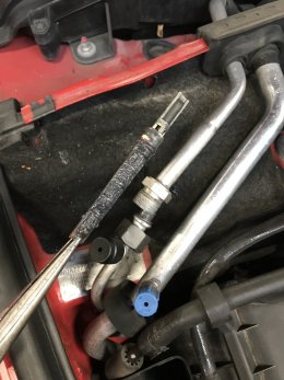

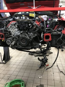

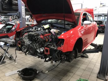

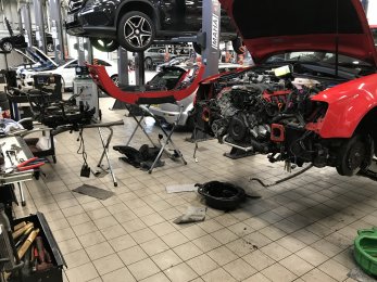

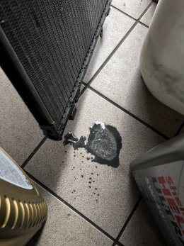

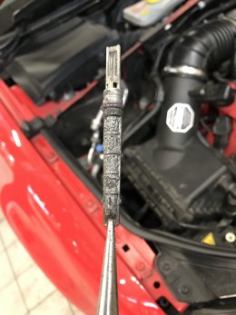

It was the orifice filter causing the compressor failures. I knew this soon as the new compressor blew a week after owning the car. Most garages overlook it. It worked after changing it. Just never quite seemed cold enough to me. I have sold the car now mind . But yes, deffo this filter will be your cause, catches all the swarf from your first failure and if not changed puts the pressures to high and blows the next. Hope this helps. You should be able to see in the pictures where it is, Offside scuttle area need to split the pipe on the nut shown

Was a fun first job after owning the car a week nice bill too and that was me doing the work as well! Hate to think if I paid someone to do it!
