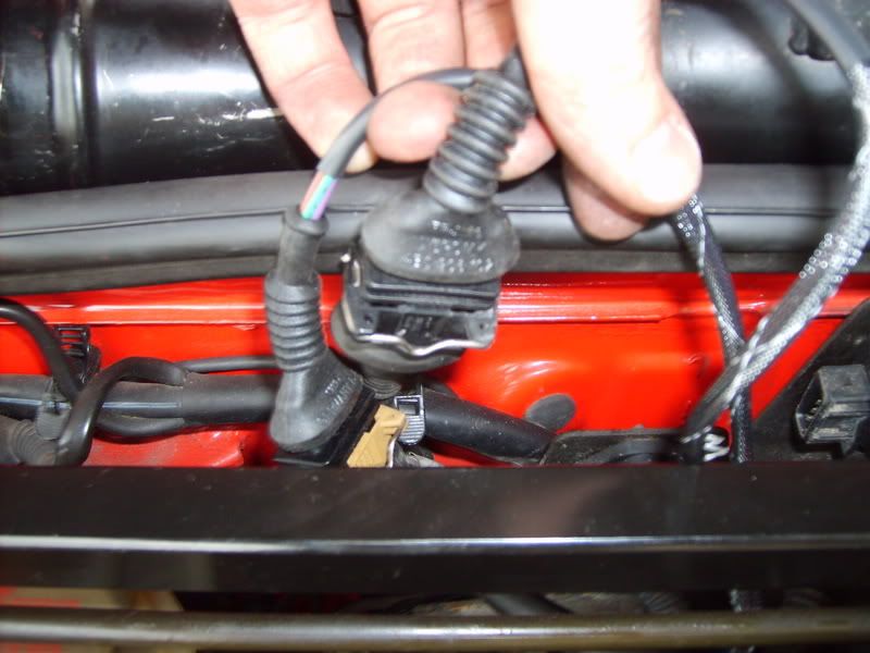

The other 2 leads that come off sit on rail, so slide out make job easier of getting them off
