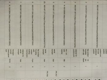

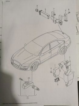

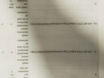

Hi guys sorry it's been a long time busy with work and life and forgot all about this site until I got a pm and an email alert.
Attached list of part numbers. You basically need 1 5 and 10 and build a loom the rest are optional. And wiring diagram attached. Give me a shout if you need more detail I'll try to remember.
I still have the b7 but it's not moved from the start of lock down. I need to get it back on the road and sold. Now driving a b8.5 Avant also retro fitted with TPMS and I did a A6 C6 in the past too.
If you can't tell I have an interest in TPMS I work at a large TPMS. manufacture in Northern Ireland
the A4 b7 system is what's called a low line system with just a warning for pressure the A6 is high line and displays the pressure by location on the mmi. B8.5 same as b7 low line
