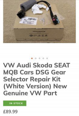

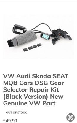

This is a common fault on the DSG/S-Tronic gearbox and affects Audi VW Skoda etc.
It is a failure of a microswitch in the gear selector mechanism. The good news is there is a retrofit part that can be fitted from inside the car in around 30 minutes and costs less than £100 and is not too difficult if you are of average mechanical competence. There are two versions which are Black and White which will match the colour of your gear selector housing. The white one is around £100 and the black version around £60. I fitted the white version to my wife’s 6 speed DSG on her 2016 Golf 2.0 tdi and has been faultless ever since.
Reactions: edd58 and rburr33276
There is a video on YouTube that shows more detail in fitting the white version and explains what the fault is.
Apparently the US and Australia has a recall to fix this problem for free.
