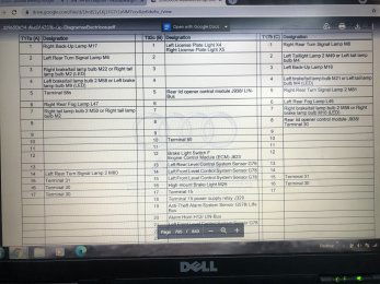

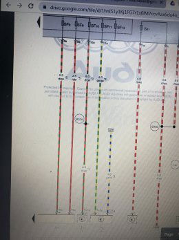

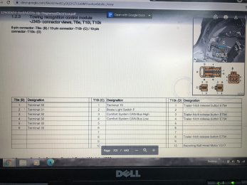

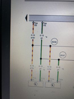

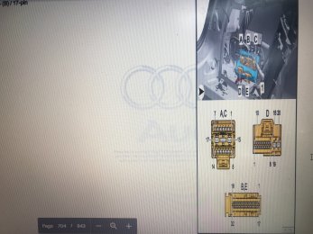

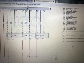

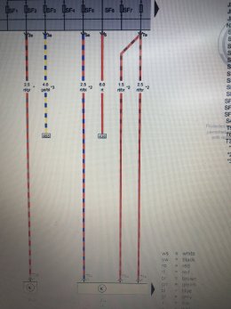

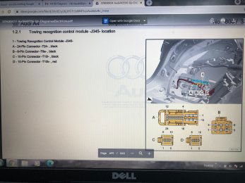

Today I installed a towbar to my Audi A4 B9 on my own and everything works like a charm.
I would like to thank @Daniel Orsborne for provided instructions - It was really helpful.
I would also like to share my experience that could be useful for someone, who will be installing a towbar basing on used parts (in particular used electric harness) like me. In short words, I bought a used wiring harness (the one that connects the tow controller with the electric system of the car). In my case, the connectors that are used to connect pins from the convenience system were cut off. I had to identify plugs and connectors (pin) to fix harness before mounting it:
- 3 pin socket housings that are used to connect pins from 32-pin connectors (named "B" & "E" in the manual) are:
3-pin MQS (Micro Quadlock System) male/female socket with MQS pins (part number: 000979012E for male and 000979009E for female)
- 2-pin socket housing that is used to connect pin 5 of 17-pin connector "A" is:
2-pin MCON male/female socket with 1.2mm flat pin (part numbers: 5Q0973802 for male and 4H0973702A for female)
Basing on a wiring instruction of your car (SM_48 wiring), towbar installation manual, and information provided above, it should be very easy to connect sockets and fix harness.
In case of questions just write them in this thread or contact me directly using PM. I will be happy to help.

Well I just finished my a week ago
I did find all necessary wiring which have to be done and was missing two one was power switched and one from brake switch F
If you need some help let me know I can tell you what where if you have all wiring with it ..
I did all by myself just the one what go’s from to car was there on tow hitch originally
If you can mate. My car is in bits.
I have 4 power wires for fuses and 1 yellow/black.
I’ve done the 2 can wires pin 1 and 2
A black/ red and black that went to pin 12 and 17.
Does anyone have the diagram they could send? Car is in bits at the moment.
Hpe its help
