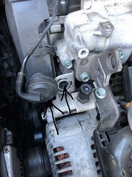

EXCEPT there being NO vacuum being held at the Inlet Manifold Actuator.
I have purchased a replacement actuator from TPS for £14 and the garage are going to take the Inlet
Manifold off, clean it and replace the actuator

Well your vacuum unit for the inlet manifold is snapped for a start so that is probably why it isn't performing!! Would have thought the garage would have noticed that as its painfully obvious. I'd suggest using a different garage where the mechanics aren't blind!
I had my glow plug warning light come on a week ago while on the motorway and it has been running a little lumpy at around 2000rpm and lumpy at idle plus smelt like it was really overfuelling. I replaced that vacuum unit and the idling is fine, on my test drive the lumpyness had gone away and it seems like the fumes are less toxic than they were! I've not had chance to give it a good run since but it appears to have worked.
The unit I took off had a small hole in its diaphram which I expect is the issue.
My turbo still doesn't come on to full chat until around 2500rpm which I know is too high, but the car is running so I don't care too much now as I've order a new one so it just needs to keep going for a few months!

Hi, Just want to ask , about what vacuum unit you talk?
The black circle type disc at the end of the black tube in the middle of the pic, the 2 should be joined.
