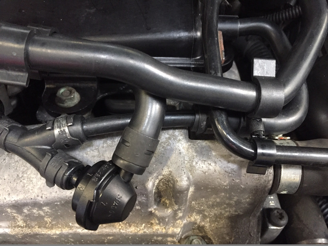

hi
Just wondering if anyone nows what this tube is and if they could put a link in to find it as mine is broken see in pictures

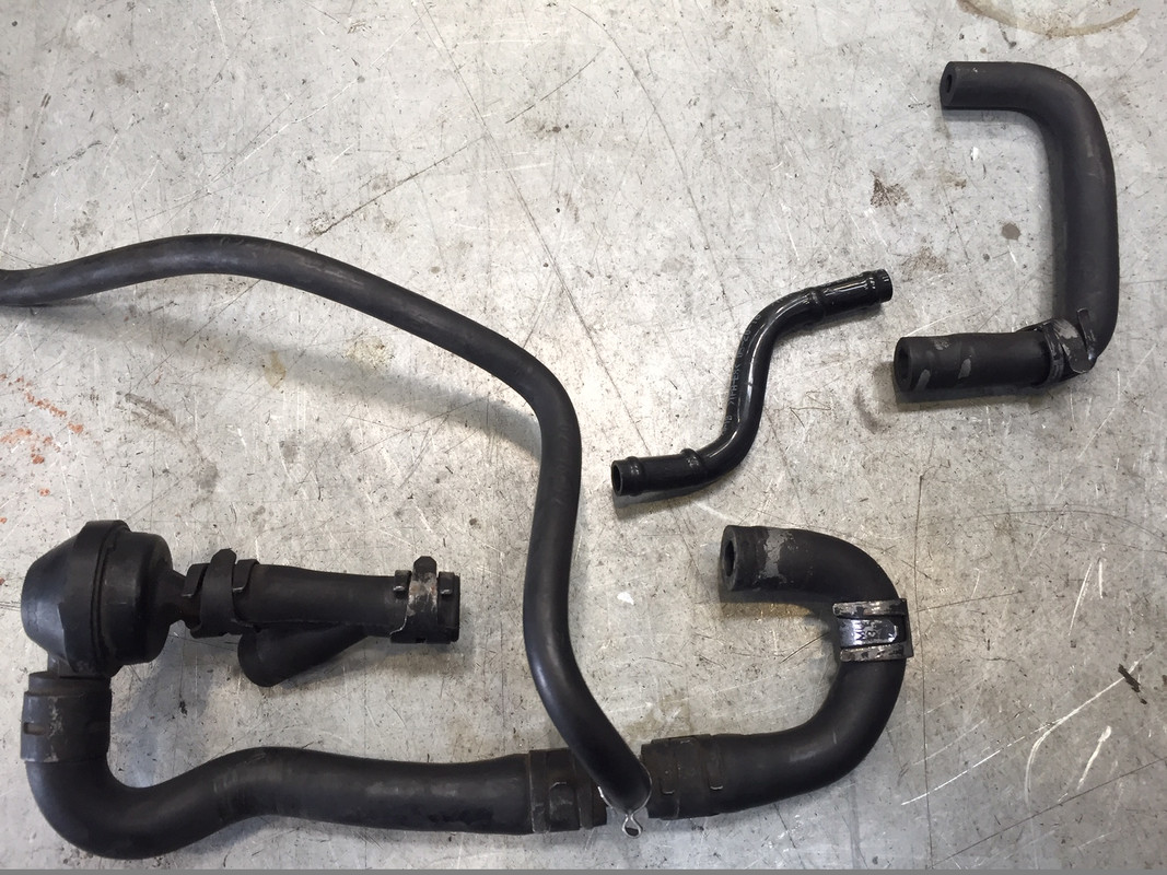

This is the tube

This small hose

That pipe does not have a part number, it comes with the pipe set for the N249 valve, part number 06A133773G (BAM Engine)
I brought and changed this pipe set last week on my car but didn't use the pipe which you need, i used my original pipe as i wanted to keep the original pipe routing.
Send me a message and i can post this pipe to you on Monday if you need it.
