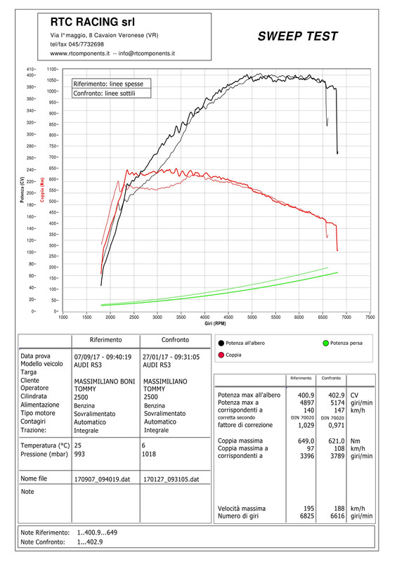

From my personal experience I advise you against moving to Stage 2 Revo. I did not find the declared data on the dyno. You only have more torque at 5,000 rpm. I also couldn't find a 100 octane gasoline suitable for the REVO 98+ map. With all the 100 octane gasoline available on the Italian territory I found some worrisome ECU corrections (also - 9%). Mounting the 200-cell down pipe is a truly significant operation, it is necessary to remove both the transmission shaft and the lower suspension support.
If you want to do some up grade I suggest you Wagner intercooler, secondary decat, K&N panel filter. On the 8V the turbine is small and does not allow it to exceed 400 hp.
Reactions: Callum66
Thank you for the for for information. It is helpful to see the feedback from a customer.
It looks like the results do not match the effort and cost involved in going to stage 2.
As you suggested smaller upgrades will give better cost to performance results rather than a full stage 2 conversion.

Had it on the dyno today with it producing 444 hp and 640 nm at the fly.
The map was the 98 octane as the 102 map should not be used unless its with 102 octane fuel.
I'm happy with the numbers. It will be interesting to see how that performs on the runway.
