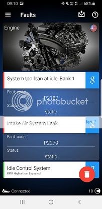

Plugged in the OBDeleven, started the car and got some info...
A quick google detailed that this would be an air leak after the MAF causing the engine to run lean. A couple of mins later, I detected a sucking noise coming from the PCV/Oil Separator at the top of the engine.
