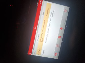

Hi. I have a similar issue on my 2016 VW Amarok Highline and have not been able to find a solution. I appreciate any help. Thank you so much

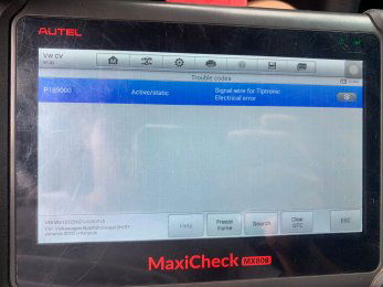

Getting the same error gearbox malfunction audi a6 2012 with the following fault codes anyone seem to have fixed the problem?
