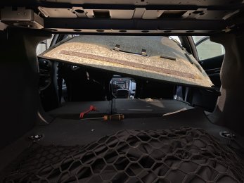

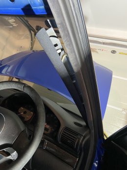

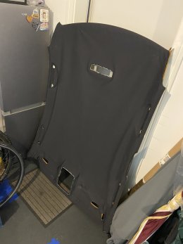

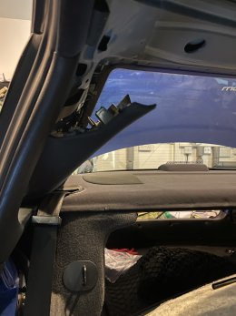

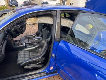

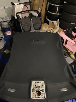

While it’s been tucked up in the garage I decide it was time to tackle the headlining. Been putting this off for a while. Been sagging for best part of a year now.
Went round and removed all the lights, grab handles, sun visors etc. All straight forward. Pillar trim was a bit trickier though. I was super worried about breaking something but fortunately managed to get it all out with only 2 clips deciding they no longer wanted to live. Also managed to get it out without removing the internal B pillar trim but this may need loosened for refitting.
Bit it a squeeze getting it out the boot of a saloon too.
Going to take it to a local upholsterer and see what I’d be looking at to have it done. If it’s crazy money I’ll give it a whack myself but it’s really not something I’m keen to do.

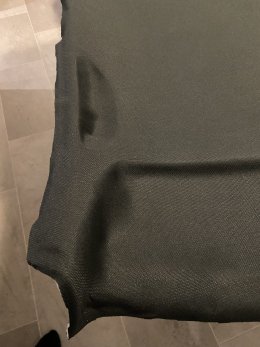

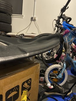

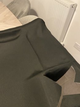

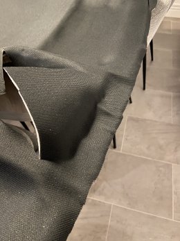

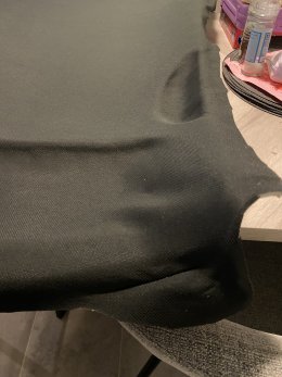

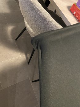

Well I finally got my headliner back at the end of February and have to say, what a shambles. The level of workmanship is nowhere near what I would have expected. I’d genuinely question if they’d ever done one before.
Areas not stuck down properly, creases, holes for the light units not cut out, grab handles and sun visor holes not cut and the edges in general just finished so poorly.
Raised my concerns when I was collecting but was pretty much brushed off and told it was normal and would never be as good as it came out the factory. They stuck some more glue on one area of concern and that was it. I did get a small amount of money off but in all honesty I would have been happier to pay the full amount and have them do a decent job.
And the kicker - they had it for 6 weeks longer than they said they would. Just a total shambles from start to finish. I’ve been using local people/trades/companies for stuff on this car and previous cars for close to 2 decades now and this is genuinely the first time I’ve felt proper taken for a mug.
Maybole Upholstery based in Drongan, Ayrshire. Avoid like the plague.
This is what I was presented with at collection and what they obviously deem to be an acceptable level of workmanship:

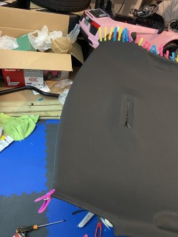

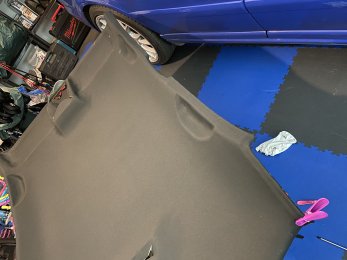

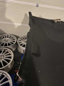

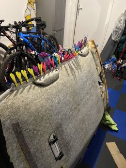

Anyway when life gives you lemons, or a headliner that looks like it’s been re-trimmed by a complete lemon, you make lemonade.

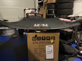

Since getting it back I’ve spent a fair bit of time on it. Cutting out the recesses, tidying up the edges, re-sticking areas that hadn’t been done properly etc and it’s actually looking pretty decent now. Basically how I would have expected it to come back. Honestly wish I’d just did it myself, it’s not a terrible job.
One of the main issues I had was with the way the edges had been cut and finished. Think it was someone’s first day on the scissors. The rough cuts weren’t an issue round the sides as they’d left JUST enough material for me to fold it round and glue down to create a nice smooth edge. These edges are also hidden when installed behind a little lip. The rear edge isn’t hidden but again there was enough material for me to double it back and glue down. I actually had to cut off a fair bit of material here as the rear edge hooks onto the car, so had to make sure the channel was clear to allow it to do so.
The real issue was at the front. They’d cut the fabric tight with the liner, very rough and with nothing extra to fold over the edge. The light coloured foam backing was visible and it looked terrible. This was a problem as this edge is exposed when fitted.
I scratched my head for a while but remembered I had some protective rubber edging lying around that I’d used on my pole position side mounts when I trimmed them down to get the seats lower. So thought I’d see what I could do with that.
And it worked a treat. I wasn’t able to just push it on given the fragility of the liner, so I went along and opened it all up, slid it on, then went along and pressed it closed nice and tight. The front edge now looks pretty tidy and I actually don’t think the rubber edge looks out of place!
I then went round and opened up holes for all the light units and sun visor holes etc. I’m actually glad they didn’t touch these as who knows what they’d have done.
This is how I had it looking pre-installation:

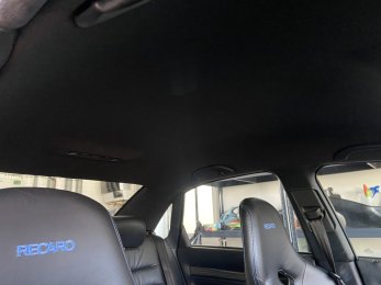

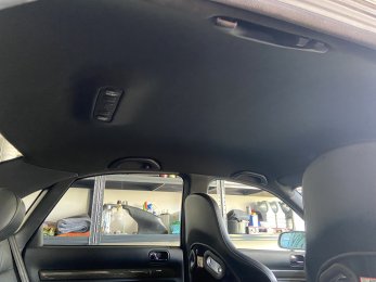

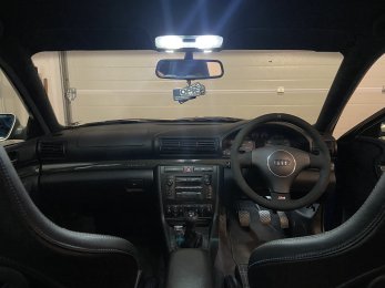

I sat on it for a few days after finishing my improvements – thought it was going to be a nightmare to refit. But apart from actually getting it into the car, it went back in place fairly easily. Unplugging the front central light unit also causes an airbag light on the dash due to the ‘passenger airbag off’ warning light being located there. So my hand was kind of forced with MOT due this week.
I’m really happy with how it looks fitted - something I did not see myself saying when I got it back 3 weeks ago. Probably taken an extra 6+ hours of my time to get it to this stage though. Only positive is the material they used is a very good match for the car, blends in well with the A/B/C pillars. While everything was out I also took the opportunity to upgrade all the bulbs to some LED ones. It’s one of those things I wish I’d done ages ago – the bulb kit was only £12, it was an easy job, and the car is so much brighter inside now.

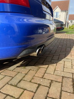

I had the tail pipes moved out slightly recently too. They sat way too far in for my liking and it just didn’t look right. Took the car to Elite Custom Exhausts in Ayr. Job was priced and booked in, the work was completed to spec, on the arranged date and at the agreed cost. Much better experience from a local company.
Also swapped the original side lights out for some LED ones and my god what a difference. Didn’t appreciate how old and yellow the originals looked until now.

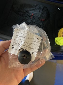

If anyone finds themselves missing any of the plastic retaining nuts that hold the boot side carpets/liners in place here’s a part number for you. Noticed I was missing 2 last week, no idea where they’ve gone. Local Audi garage said they couldn’t get them anymore, local VW dealer for them no problem. Only £1 a piece, an unusually cheap part for the B5.
