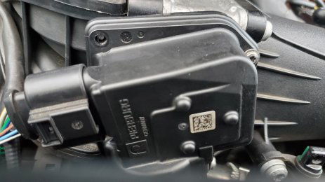

there is a locating peg on left at swirl flap motor mount, also underneat there is a bracket mount torx screw just on right of egr metal flange
Yes as above, once the jubilee clip is moved out of the way you can get access to it down the right hand side.

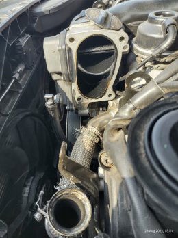

Managed to get the black pipe off and the swirl flap housing and plastic pipework were all caked in the black stuff. All cleaned off and also decided to remove the butterfly flap before reassembly. The car definitely seems to run quieter, smoother and more responsively. My car's a 2012 model with 112k. Thank you OP :icon thumright:

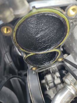

The main reason i removed mine was to see if i could get a bit more induction noise to compliment my k&n filter and my muffler delete but car still sounds stock unless it (very rarely) goes into dpf regen where it gives a nice exhaust note.... so trial and error on the cheap really
Been running mine for over a year now with the runner control flap removed but put it back together yesterday
pictures show the results in about 14 months use.
Not major mileage (5k)as this is a second car but like to put the foot down when using it , its still pretty clean / just a light misting of oil from the pcv return into engine....no excess soot from egr mixed through that is a credit to offsetting the egr stroke settings from my obdeleven
All back together i have noticed better low down torque with this fitted as it was intended from factory in my opinion so i am happy knowing it is clean and fault free back to factory spec
i would probably remove it again temporarily if the motor went faulty saving me a few quid until i could be ***** replacing it. But by looking at the built up soot blockage on some of these members pictures i would hazard a guess that is the reason they jam / fail
pictures are of strip down before cleaning and refitting flap.
20 minute job to take apart and refit on a yearly basis if needing cleaned

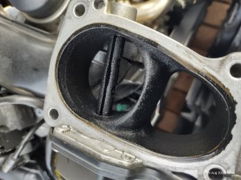

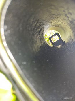

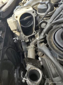

Just cleaned and removed my flap also. Shout out to the original OP who posted this!
I've done the disconnect test and I really noticed a reduction in clatter in low RPM. So proceeded to take off and clean. However now that it's all back in with the Flap removed, I find that it is not as refined as when I did the disconnect test!

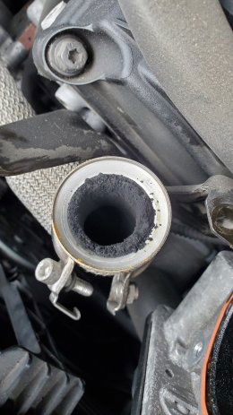

I'm thinking it could be related to the EGR valve itself, as from what I've picked from other posts is that disconnecting the swirl motor actually also shuts off the EGR. So planning to do another disconnect test to see if it runs as quiet as it did with the first test. If it runs better again then I guess I need to do something about the EGR, I don't have VCDS/OBD11 as of yet.

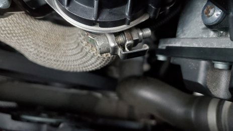

Another possibility and question is how tight should the EGR clamp be? I've done it as in attached photos but wonder if that is too tight/loose?
And lastly, I've managed to shear off two of the small torx screws that hold the motor housing and wondering if that is an issue now? Photos attached.
Now I'm actually thinking of just selling the car and buying a petrol for an actually smooth engine!

Nice work, any chance you could let me know how tight should the EGR clamp be when installed? I've done it as in attached but not sure if that's too tight or too loose? Thanks.

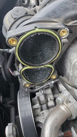

Just did this on my 37k 2015 SQ5. I'd guess it was 50% clogged up. Surprised how soft and easy it was to clean off with a bit of carb cleaner and an old scraper. I wondered if the plastic inlet manifold was also affected? Has anyone gone the whole hog and checked this out as well?
yeah I did it last night. Just wanted to chek the EGR but when i'll looked with the flashlight into the intake manifold it was also clogged in there :/ So I took the intake manifold of and cleaned it. Also did the swirl flap delete, runs also smoother and much better idle.

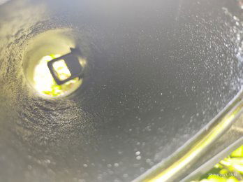

Symptoms: when idling and accelerating on cold engine misfire starts when revs go up. On warm engine this symptom disappears. Also misfire happen time by time when cruising on low rpm. Sometime engine misfiring when gear goes up.
All injectors was tested and one restored. When it not helped started to think about air supply and EGR problems. After plans to delete DPF and EGR tryed last call to google something less radical and BINGO - this post :)
Two hours of dirty hand work and all problems disappeared. Engine runs smooth now. I chose to clean a swirl flap and intake pipes and delete flap. Made no correction on EGR adaptations because all cleaning process are very simple to repeat after couple of years.
