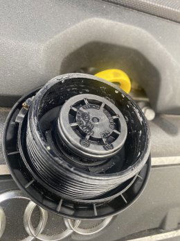

Wondering if someone could help, topping up coolant, notice something that looks like white chalk around the cap of the coolant reservoir cap, something to be worried about?
I’ve seen it before.
It’s the residue from coolant when it dries out.
I sometimes notice it more on the threads of the cap.
I just give them a clean now and again.
