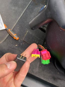

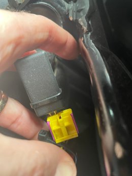

This may or may not help you. I used one of these inserted as follows.
U have that plugged in the whole time and the light disappears after u clear codes?
I have it plugged in permanently yes. I fitted it when I installed pole position seats. I never had an airbag light on as I disconnected the battery, installed the resistors along with the new seats, and reconnected the battery.
If you have confirmed it’s definitely this connection that’s causing your airbag light, then installing this resistor should fix the problem after codes have been cleared. There are of course several things that can cause the airbag light to appear.
Yes thanks, i have switched seats to some that don't have airbags
