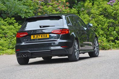

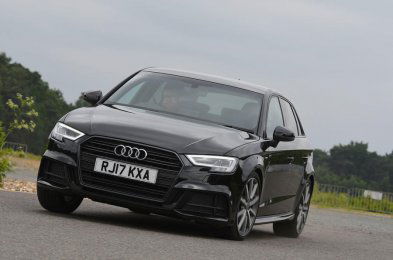

s-line black

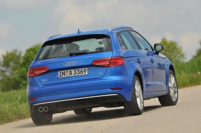

sport blue :)
You can't do front bumper unles u want to change the headlights and messing with coding and spending a lot of money

s-line black
sport blue :)

s-line black
sport blue :)
And is it the A3 sline bumper or is it an s3 bumper that fits for fl I’m confused also would and s3 diffuser fit if it’s the s3 or if it’s the a3 sline bumper
they are same .. s-line stands for that A3 has S3 body shop
except that they added quad exhaust for S3 for A3 s-line they kept twin
Just get whole rear bumper saves the hassle

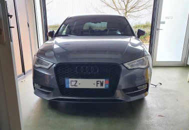

Hey guys! I understand that today is almost 2023 but plz help me with facelift. I facelifted my 2015 A3 limo.
In stock Xenon headlights.
Right now facelift Xenox headlight.
Everything works except headlights range level control. How to fix it? Please
PFL to facelift
Thanks a lot for exact description but i have Xenon headlights. This is a lot of difference between this 2 connections. I know that in FL no 55 module in Xenon headlights. Headlights range level controling by BCM. Maybe u know how to off headlights range level control?
I want just delete error from dashboard. Its the main reason. Maybe u know how to off it in VCDS?
Connect the headlight range controller (55) correctly and do basic settings to headlights..
Again on facelift bcm/headlights the 2 wires from pin1 and 2 of the headlights are combined.. on pfl they are seperate. (on matrix at least). Basic settings will not work if car doesnt see both the headlights.
I think it is different connections in Xenon and Led Matrix. May be you know how to just off 55 module without error on dashboard.
As you can see below: no 55/4b module on xenon facelift. Only BCM. This means if you cant make it work with the connections below, you need facelift bcm.
Yeah. I know. But I don't need headlights level control. I off it in 19 module and disconnect the plug but in vain.
Hate to come across you on the road... I know its a bitch to hook up the 55connector to bcm.. But I guess its your only option. And better for everyone...
I checked. No any problems with the light for somebody. Really. Sport susp lowering
Checked with 3 persons on back seat, trunkload and a trailer hooked up?? Thats what the height sensor is for.
Do it right or leave it alone...
If headlights then still not blinding your own headlight image will be pointing down a lot. Without passengers.
Retrofit isnt complete without the height controller..

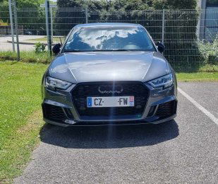

Hi. I'm in the process of collecting parts to change the pre-facelift to the facelift. I currently have pfl xenon headlights. I'm planning to install xenon FL headlights. Can I use pre-facelift converters in pFL xenon lamps? My current number 4g0907397P
Wysłane z mojego SM-G988B przy użyciu Tapatalka
Hello,
I too have just done the PFL to FL conversion but I too now have a dashboard light :(
"Headlight level controller"
I don't quite understand how to fix the problem, with the 55 or bcm module ...
Can someone explain clearly what to buy and how to connect? I can pay if needed! @markrol
Everything is work New front, new headlights (from bixenon to full led), new radar and new 3q0 camera.
Reactions: markoGTI

Hello!
I wanted to tell you that I've finally retrofitted to facelift my car with full led headlights! Everything works perfectly and without any error neither on the dashboard nor on VCDS!
I'll try to explain the procedure in as much detail as possible.
I originally had Xenon headlights.
While doing my research, I came across this video: Youtube : youtu.be/r7kxjbLNNto
In the video you can see that it was another guy, an Italian, who did all his retrofitting. So I contacted the Italian guy and he agreed to help me. You have to realise that it's quite complicated...
You need to buy a new 55 module (auto-leveling), which the Italian programs with VCP (so you send it to him and he sends it back to you), and you also need to modify the plug wires for this module, adding a wire from this module to the BCM.
You also need to modify the headlight plug and add a wire in addition to the fuse box to each headlight.
All this is explained in the video, now it's the part that isn't explained in the video!
In fact, the Italian connects to your PC with VCDS, code and, above all, makes lots of adaptations to the 55 module and the headlights.
If you have purchased headlights with factory-fitted ballasts for this headlight,, everything should work straight away!
If, like me, the ballasts do not come from these headlights, you will need to recode the ballasts... Fortunately, I managed to get hold of a VAS and an ODIS (clone but it works), and by buying a 1h session with Geko, you can do reprogramming online as if you were doing it at Audi! You can also unlock components etc... I think it is possible to program module 55 in this way without shipping the module to it.
I know a bit about VCDS, and I could have done the operations myself with the procedure to follow, but, of course, Italian doesn't give you the procedure :)
The same goes for online coding with ODIS, I could have done it, its didn't look very complicated, but you need to know where to click.
And that's it, my car is now a Facelift :)
How much did it cost? Here are the expenses:
Headlight : 1 110€
Module 55 : 39€
Italian : 370€
Session Geko : 24€
Bumper : 400€ + 150 (paint)
Total : 2 093€
On the other hand, I sold :
Xenon : 400€
Bumper : 265€
Total : 665€
2093 – 665 : 1428€
It's up to you to decide whether it's worth it :)
Sorry for my English
