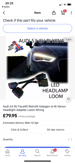

Hello, recently fitted xenons to my car, some blind bat drove through red lights and smashed it last week,:gun2: so now thinking to do the facelift conversion as car needs a bumper/ headlight and both wings anyway
anyone know if the facelift headlights are a straight swop over or wiring different?

It won’t be a straight swap, it’ll require modification.

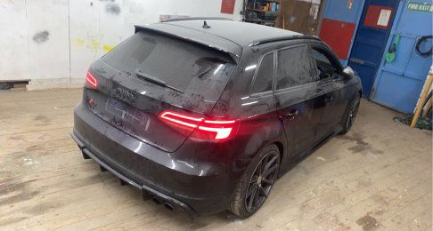

Yeh iv sold that now got a black one now delivered today doing the full conversion including the virtual cockpit. I have a few bits the light u want I do have have a look at the item number on eBay 163983066017

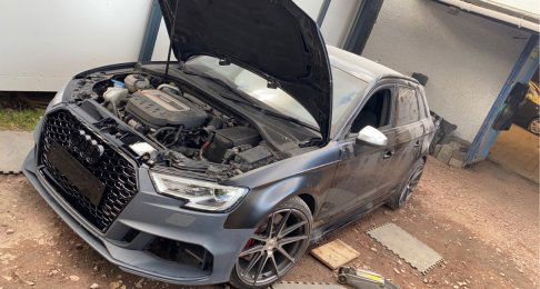

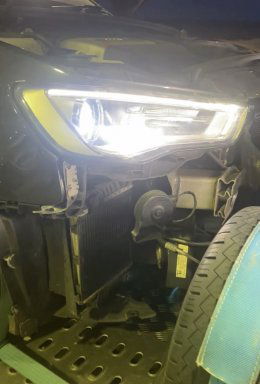

Hello sir, im doing the pfl a3 to a3 fl headlight and rs3 fl bumper, for the headlights since they are xenon both pfl and fl do i use same modules and lamps ?

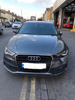

Hey guys can anyone help me out I need some advice :/
I have a s3 8v pfl car has a front end damage. I managed to get the s3 fl front bumper, grills etc. My question is will the fl headlight work as soon as they are plugged in ? Or anything wiring is required/ cording also can I fit any fl headlight,

Unfortunately if you go for the facelift light matrix etc it’s not plug and play you will need to get them wired and programmed to the car iv just done one pf to fl

If you have those lights you will just need to just extend the wiring loom as the plugs are located in a different place but yes once plugged in they will work fine however you will get a warning light. These will only plug and play if your car has xenon lights if they are halogen then will need wiring and programing. As for the bcm that can be flashed rather than replacing it

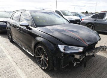

Hey mate I have a s3 8v 2015 pfl
Doing the car too the s3 fl
Allready have front headlights, bumper, grills
Will I need to change the slam panel to fl also wings an bonnet or are they the same as pfl thank you

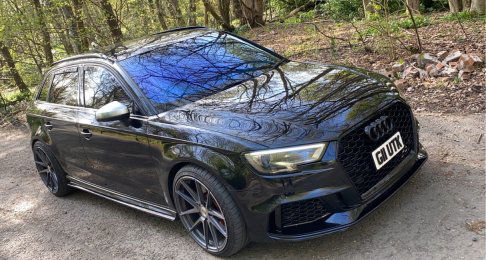

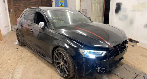

Wings and bonnet can stay all you need is Healdights, front bumper
A lot people will say u need to change the front support panel/ slam panel no true.!!!!!
pic below
I done my pfl into fl
couple months ago 3s 2015

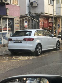

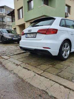

Hello all, i know this is an old post but i need help, i did the rear bumper conversion on my 2013 sportback and fitted a Fl s3 diffusor.
The only problem i have is finding the rear reflectors, i found some reflectors for the A3 fl sportback (8v0945105, and 8v0945106) but they do not fit at all.
The shape seems to be okay buy the locking plugs do not fit at all like it not meant to go there.
Can anyone give me a VIN for a Sline Fl sportback or give me the right part numbers as i can not find them
i found some 8v0945106A and they seem to be a little different. Are these the reflectors i need?

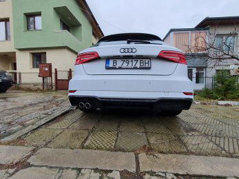

Does a facelift s-line diffuser fit on pre-facelight non s-line 8V sportback?
Correct, @Toonsoldier91 is right, you have to replace the bumper as well. I have the PFL Sportback non- s-line and went to FL s-line bumper and the diffusers on both are quite different.
@viktorSerbia I have purchased the 8V0945105A & 8V0945106A and they seem to fit on my new bump. So, the ones ending with "A" are for the s-line bump, the ones ending with "D" (same part No.) are for the saloon, and the ones ending without a letter are for the standard bump.... So, basically, yes - for the Fl S3 sportback diffuser, you will need the 8V0945105A as it's a sports diffuser, not standard. Hope I was of help

Yes it is, but if you are buying a used one, you will have to look for one with mounting liners on it - this is the part in the middle of the bumper that guides it and sticks it into place. It is not sold separately and if you don't have it on the bumper you buy, you will have to take it out from your old one, which is glued. Basically, if you do it by yourself, you will have to know what you're doing, otherwise, you will have to leave it to a car paintshop to get it sorted for you.
I will try posting pics for you later if it stops pouring outside.
So, basically this is what it looked like before and after
