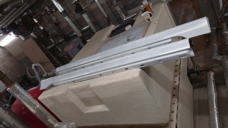

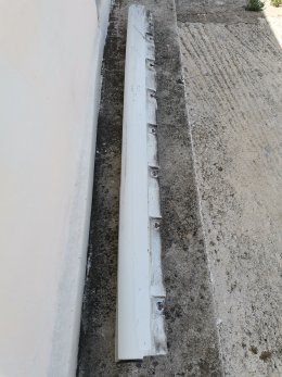

I need help to know if this side skirts can fit on my car
side skirt 8P3853859
car a3 8p 3door facelift 2010 model

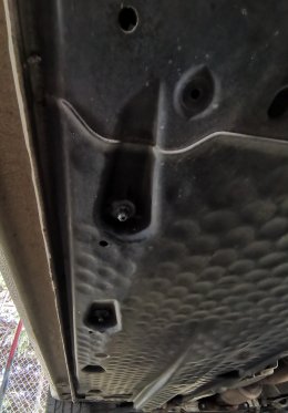

Thank you again. I finally fitted mine!
This is the view underneath my car. A3 3 door, 1.8 2010.
I suppose the s3 have plastic screws to tighten the side skirt.
I used adhesive (use better adhesive in the color of your car or transparent adhesive) around these holes. I also used car jack with plank of wood and paper tape to keep it in the correct place. It sits very well but, in one side, there was a little gap. So, I used these to be sure its ok.
After fit these plastic screws
When you place the side skirt and this corner see if the lines are ok between these parts. Then use paper tape to keep it in correct place.
On these we can use double sided tape or adhesive over the old tape if they are second hand
Use and here paper tape all over S3 door moulded sills
Park your car for 24 hours, take off paper tape and enjoy!
*I’m sorry for my English

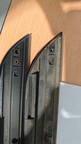

how do you mount the downer door blades on the 5 door model? i cant mount the screw, because the holes arent correct.
