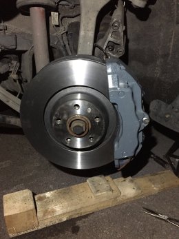

I’ve wctually got the V8 front disc(350mm) fitted under the 6piston callipers from a Touareg on the front of my A6. I’ve not got round to upgrading the rear yet but some V8 or S6 rears are what I’ll be fitting.
Here’s a pic of mine fitted. Not the best pic but you get the idea.

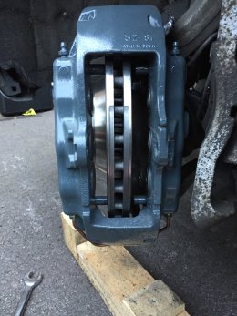

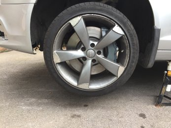

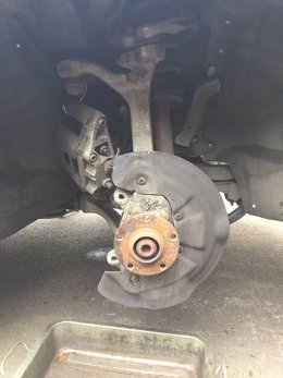

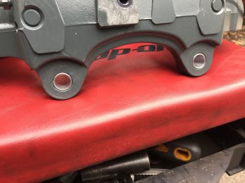

I've got myself a set of 6 pots from a Cayenne, and I am looking for the correct discs to use for them on my C6 3.0TFSi, any suggestions?
I’ve sold the car but got the brakes still actually. I used some c6 V8 discs with mine. The discs are 32mmx350mm, the only slight down side is that the Pad supporting Pins on the outside of the calipers need to be ground down slightly otherwise they rub on the disc. The disc doesn’t quite sit in the centre of the caliper. When fitting new pads I found that the pad was a tight fit so used some fine emery just to remove a little bit of brake pad material to stop it from binding. I also had to get some bushes made up for the bolt holes so that I could use the original m14 bolts and not m16 as the caliper uses on the Cayenne/Touereg etc
