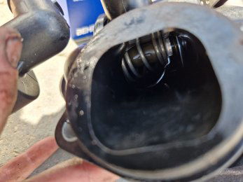

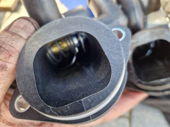

Took me 3 hours today on my a6, the plastic coolent hose at back is the hardest part forgot to disconnect battery got few sparks off alternator, my coolent tap underneath didn't empty when I turned it to drain nothing happened so just removed hose.
On the plus side car shot upto 90 1st time since owning it hopefully my mpg will improve
Got a4 b8.5 to do next
Old top new bottom
